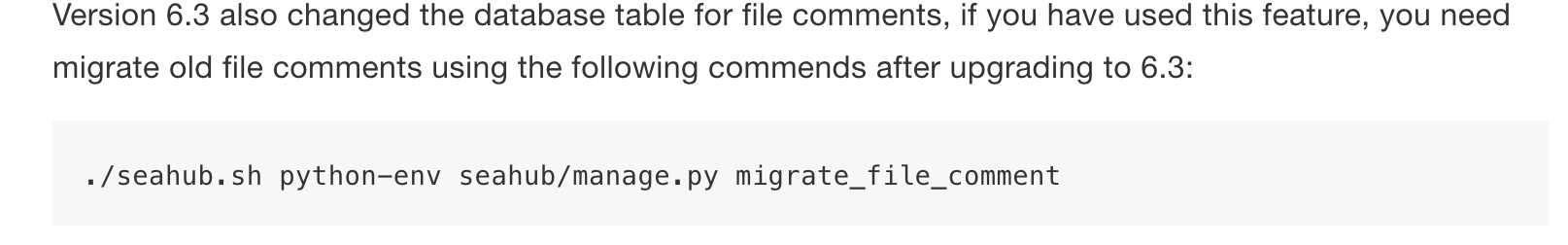

Not able to open Markdown file¶
If after upgrading to 7.0, you are not able to open Markdown file and if your seahub.log containing the following error, it is caused by you forgot to migrate file comment when you upgrade to 6.3 version.
You can delete the table base_filecomment and recreate the table.
