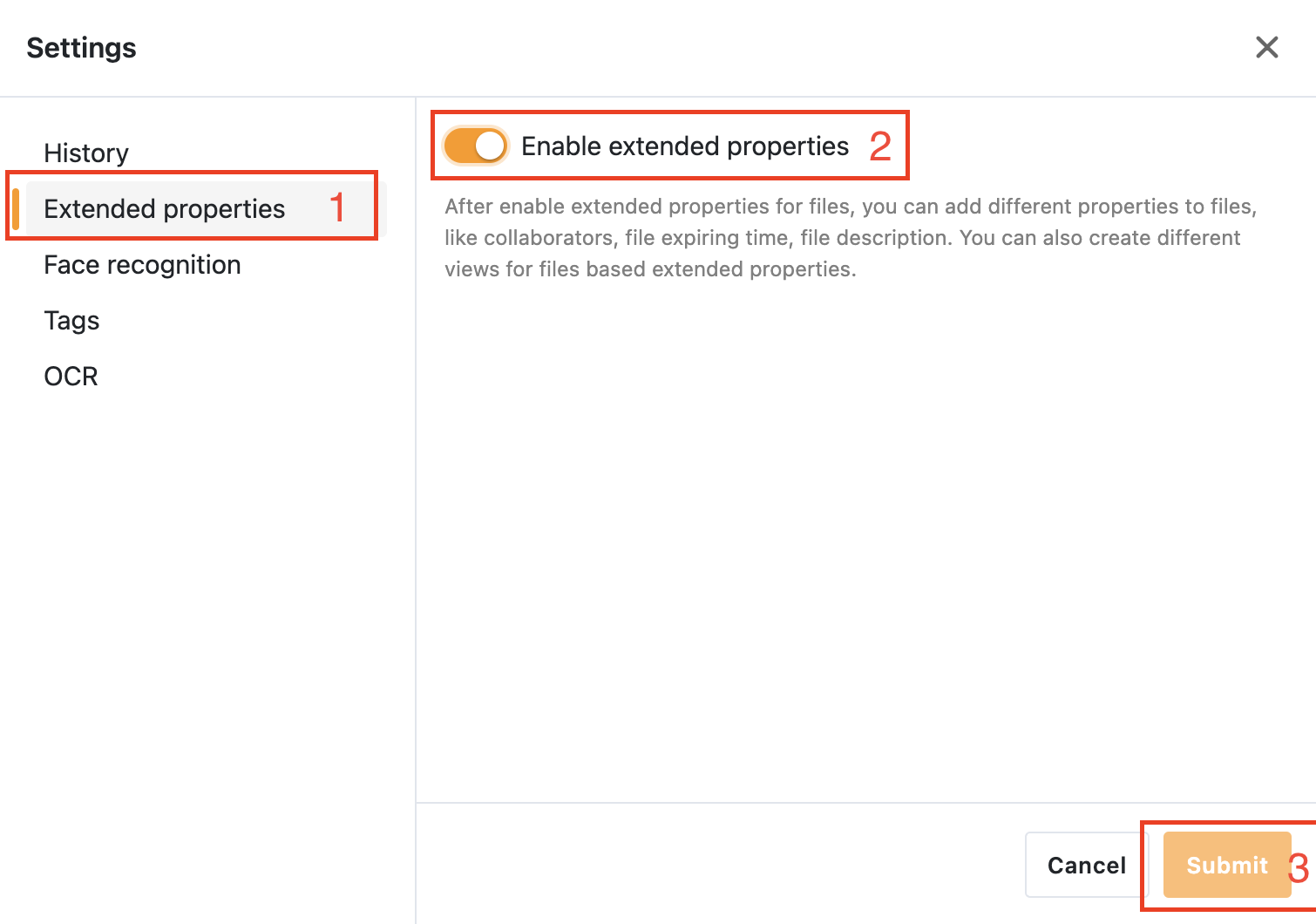

seafile-md-server, you can see the following message if it runs fine:2. Check the$docker logs -f seafile-md-server [md-server] [2025-03-27 02:30:55] [INFO] Created data links [md-server] [2025-03-27 02:30:55] [INFO] Database initialization completed [md-server] [2025-03-27 02:30:55] [INFO] Starting Metadata serverseafevents.logandseahub.log, as you can see the following information inseafevents.logand no error log is reported inseahub.log:[2025-02-23 06:08:05] [INFO] seafevents.repo_metadata.index_worker:134 refresh_lock refresh_thread Starting refresh locks [2025-02-23 06:08:05] [INFO] seafevents.repo_metadata.slow_task_handler:61 worker_handler slow_task_handler_thread_0 starting update metadata work [2025-02-23 06:08:05] [INFO] seafevents.repo_metadata.slow_task_handler:61 worker_handler slow_task_handler_thread_1 starting update metadata work [2025-02-23 06:08:05] [INFO] seafevents.repo_metadata.slow_task_handler:61 worker_handler slow_task_handler_thread_2 starting update metadata work -
Switch Enable extended properties in button Settings

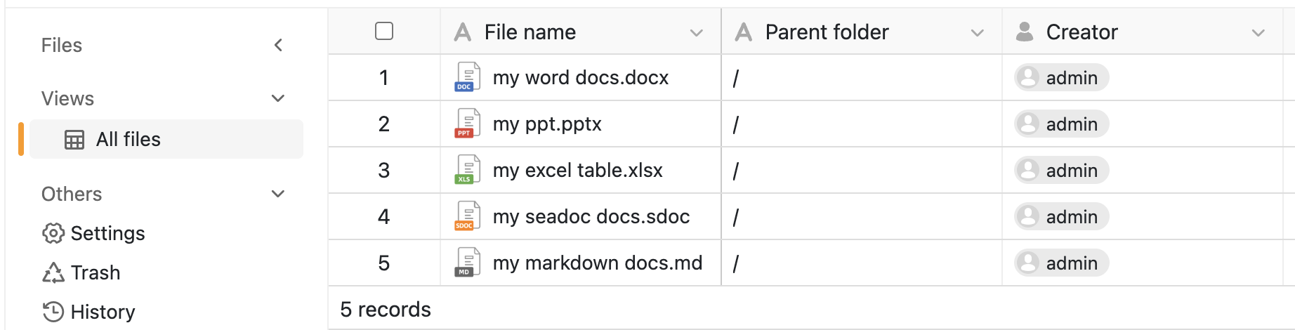

Finally, you can see the metadata of your library in views tab
