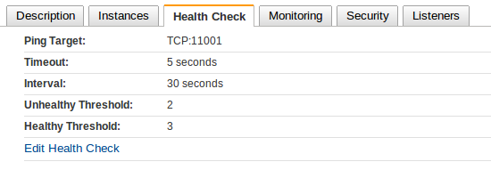

AWS Elastic Load Balancer (ELB)
In the AWS ELB management console, after you've added the Seafile server instances to the instance list, you should do two more configurations.
First you should setup HTTP(S) listeners. Ports 443 and 80 of ELB should be forwarded to the ports 80 or 443 of the Seafile servers.
Then you setup health check
elb-health-check
Refer to AWS documentation about how to setup sticky sessions.
