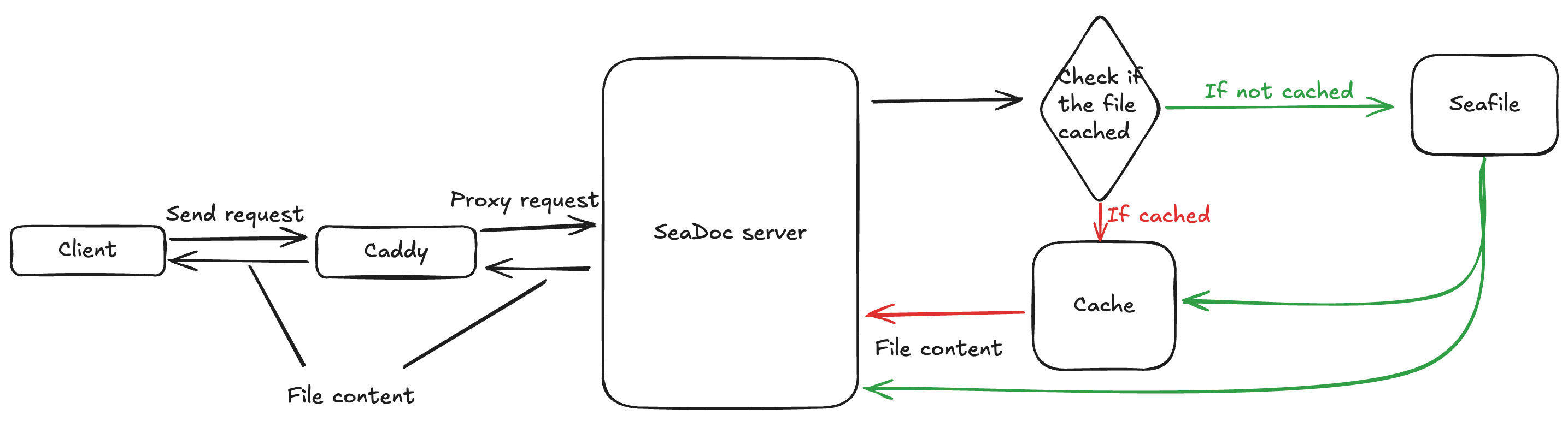

Architecture
The SeaDoc archticture is demonstrated as below:
SeaDoc
Here is the workflow when a user opens an sdoc file in a browser:
  1. When a user opens an sdoc file in the browser, a document loading request is sent to the sdoc-server.
  2. The sdoc-server retrieves the file contents from the Seafile server.
  3. The sdoc-server then sends the document content back to the browser.
