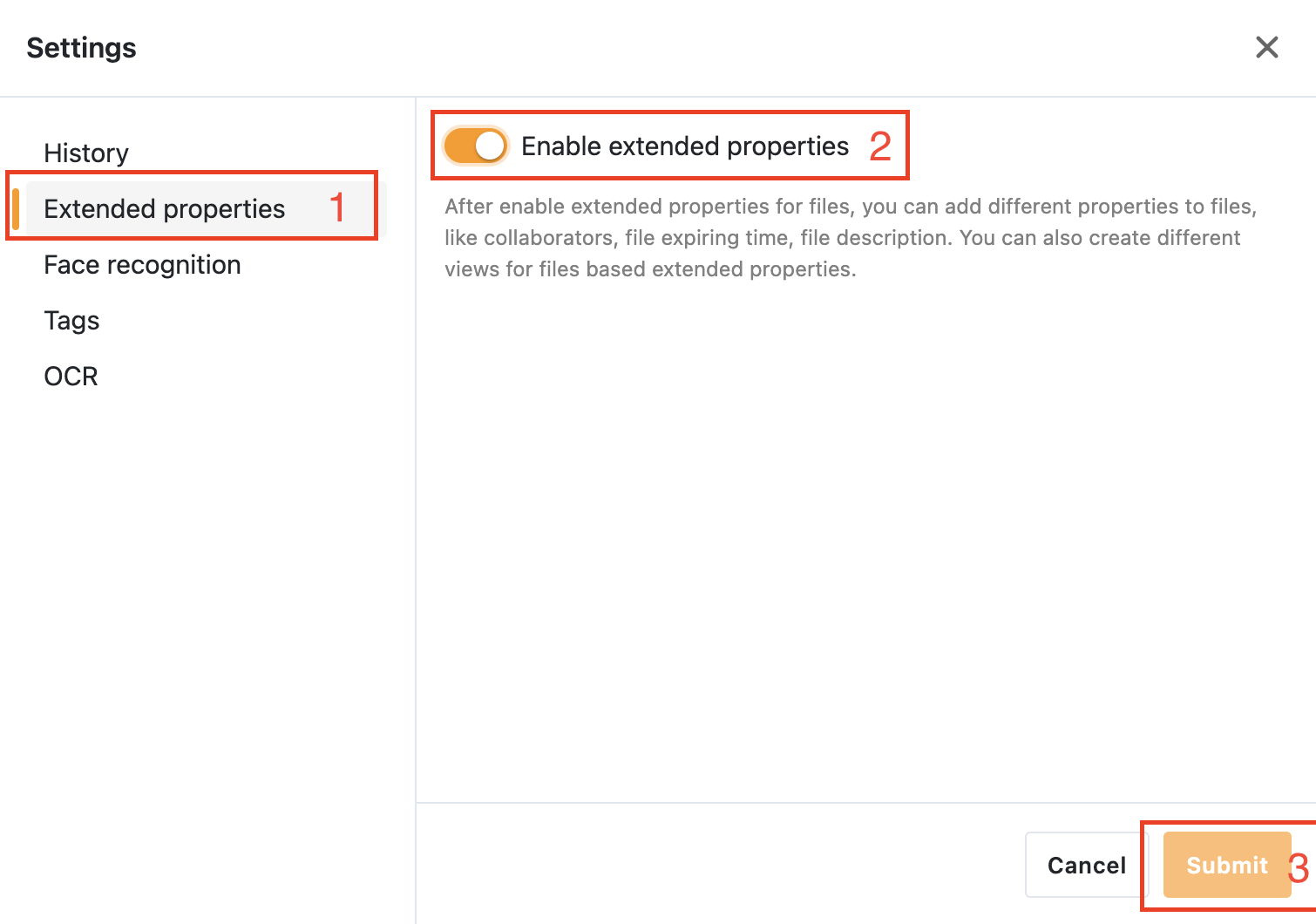

  3. Switch Enable extended properties in button Settings
    md-server-des-1

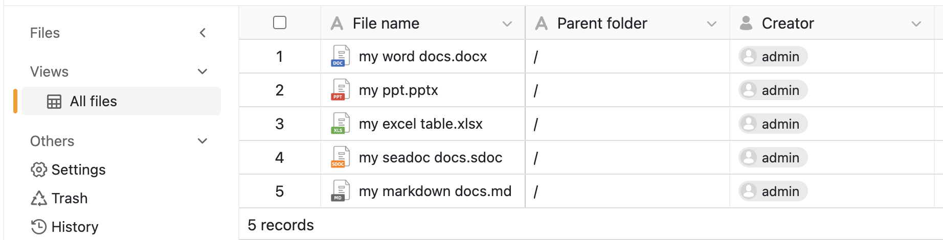

  4. Finally, you can see the metadata of your library in views tab
    md-server-des-2
